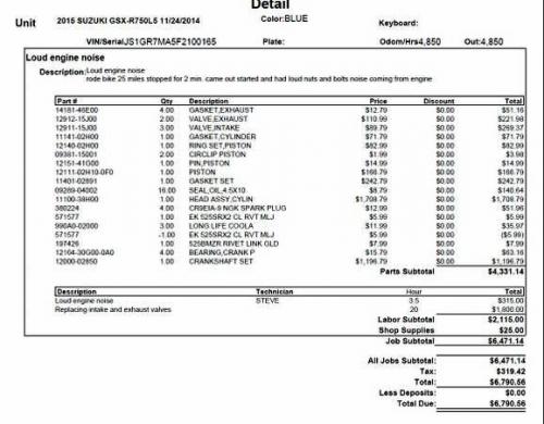

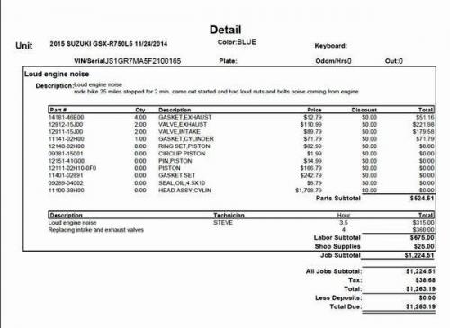

I have no opinion on your trade, but am curious as to what really is wrong with the "repaired" engine. I've copied some of the info for when the CL ad disappears.
Quote
Up for sale is a 2015 GSXR-750 - NEEDS ENGINE REBUILD. Bike was bought brand new with 0 miles on it from Cities Edge in Shakopee, MN during the 2015 summer. Bike has 4,6XX miles on it and was in perfect working order. A "non-metallic object" somehow made it's way into cylinder 4 and caused some damage to cylinder 4. A repair was done to try and fix this (see picture of repair order) - this was completed but a slight engine knock remained. Cities Edge recommendation after the initial fix was for a full rebuild.
Attached you'll see the cost of parts needed for the engine as quoted by Cities Edge. Parts + Labor was too high to justify the cost. You can just buy a used new engine (can be bought for under 2k shipped) and drop it in. At this point, I can't spend anymore money on this bike and I've chosen to sell it as-is. This bike is ideal for someone who is handy and can drop the current engine and either buy a replacement engine or get a donor engine and pull parts. This bike will be sold as a whole.
Never been dropped, and is in immaculate condition. Clean title. Bike is owned outright and does not have a loan on it. Never been wheeled or stunted. Bike has always been stored away properly for winter in a heated garage. OEM Suzuki oil and filters have always been used. Tabs are current for the 2017 riding season. Open to offers and potential trades. Pictures have race rails that are no longer on the bike. I'd like to get $4,500 for this. Bike is easily worth $8,000 with a running motor and mods. No low-balls.
I would potentially be interested in other motorcycle trades. Worst that I can say is NO.
Attached Image: 00404_3X9UKCRieUm_600x450.jpg
Attached Image: 00h0h_5REFxft5GCg_600x450.jpg
The first repair cost $1263. It appears they replaced 2 intake and 2 exhaust valves (although other parts are listed, but not included in the final price).
The second repair estimate is for $6790. Curiously, it's a copy of the first repair order's parts (including the stuff that was not actually installed the first time) plus a "crankshaft set", and miscellaneous items like a couple master links, spark plugs, and coolant.
I've never worked on a 2015 Gixxer, but can you pull the head (to replace valves) without removing the engine from the chassis? If not, I'm wondering if the original repair was actually done (as the labor cost is low for all that effort).
Bottom line, if it were me, I'd want to disassemble that engine to see what's really wrong with it. In fact, a non-invasive leakdown test would tell you if there are bent valves.
P.S. I see you're in WI, but in MN if you swap an engine on a street-licensed bike, you are required to have the completed bike inspected by an agent for the state.
