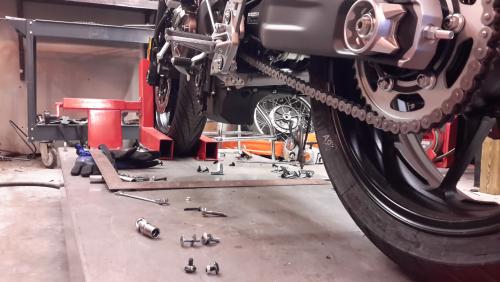

View PostChamp, on 29 September 2015 - 08:28 AM, said:
Looks like it's already in the discard pile :thumbup:
Kickstand, schmickstand, gonners.
Attached Image: 20150929_092918.jpg
Even though everything is not in for the build, I couldn't resist... :HappyDance1:

Posted 29 September 2015 - 09:18 AM
I'm curious how wide the motor is down low - do you feel it will be prone to scraping when lowsiding?
[/quote]
The motor is 15 inches at the widest point, same as the SV. The sump on the FZ is very different than the SV though, it hangs much lower. (See pic) The SV sump is between the lower frame butresses, quite protected. The FZ sump sticks down like a orangutan's ass. Speaking of frame, the FZ is much more dainty between the lower rear swinger/frame junction, fingers crossed for strength, hope Yamaha pays for good engineers...
Attached Image: 20150929_085847.jpg
Attached Image: 20150929_101705.jpg
Most modern supersports feature this type of sump and they generally keep their oil inside I guess.

#28 User is offline   re tired Icon
  • Posts: 759
Posted 29 September 2015 - 10:12 AM
Undressed she tips in @ 325 pounds! I left the bars on for now to hold the controls out of my way, waiting on the frickin UPS/FedEx guys... racers are known for their patience ...
