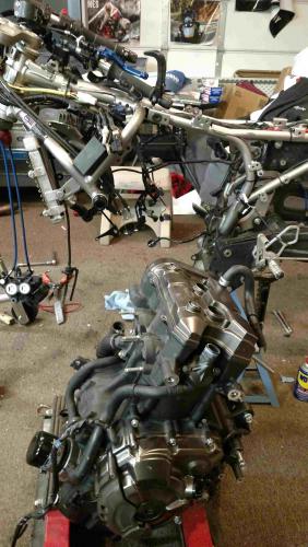

Sounds like there's some serious shit going on over in the Suzuki camp so I thought I'd keep rollin. Pulled the motor out of the frame,
Attached Image: IMG_20181208_231151.jpg

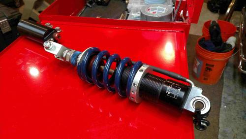

To do so, the shock has to be removed as it attaches to and levers on the back of the engine cases. This reminds me of my big gripe about the JRi shock. Spent $900 (at the time, less now) for a shock with a misfit clevis that requires it and the shock linkage to be relieved for clearance AND have 2 washers slipped in as spacers because it is too wide. Spent 2 years bugging JRi for their promised correct-fit clevis only to be told ultimately to forget it, they're not going to address the issue. It appears there is a ton of preload on the spring but it actually has a very short free height. Also made of a finer wire gauge so it doesn't coil bind due to short working length.

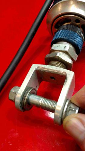

Here you can see the professional machine work on the clevis and the high-end washers used to center it over the porkchop.
